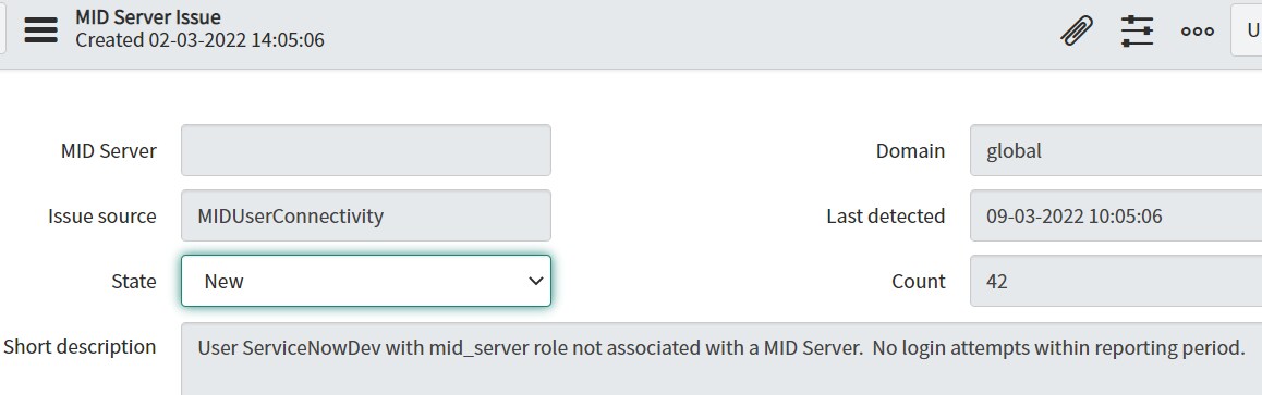

I got the below issue under MID Server issues

Hi Raj,
I followed the KB, but still its not working. MID Server record is not create din ServiceNow but getting below error.
I changed MID Server user password and tried re-installing. The server appears to be up and running and a new KeyPair value has appeared in the config file
Hi Jyotsna,
I hope you have assigned the mid_server role to the MIDServerDev user.
"The issue record does get automatically cleared once the MID Servers are installed, but the MIDUserConnectivity job that creates and clears this runs only every 4 hours, and so there a time when this error can cause confusion"
I feel it is expected as per KB0957056
Change the state of the issue to Resolved and monitor it for a day and see if you have any new MID server issues.
