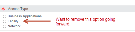

It looks like your solution is for select box variable types.   The variable that I'm trying to work with is a Multiple Choice type (radio buttons), not a select box.   From what I understand, multiple choice variables are completely different from select boxes and more difficult to work with in terms of hiding/disabling choice options.   I don't want to change the variable type from multiple choice to select box or anything else since this is how the users want the form to be.
