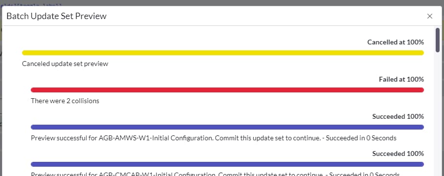

I'm facing the attached issue.
When Preview update set batch, the progress bar display that has been cancelled and no further action is allowed. There is no additional information available.
Thaks in advance for the support.
Hemanth M1
Hi @Alberto Gonz_le ,
Could see two collisions , Close this preview window and take actions on them and commit the update.
