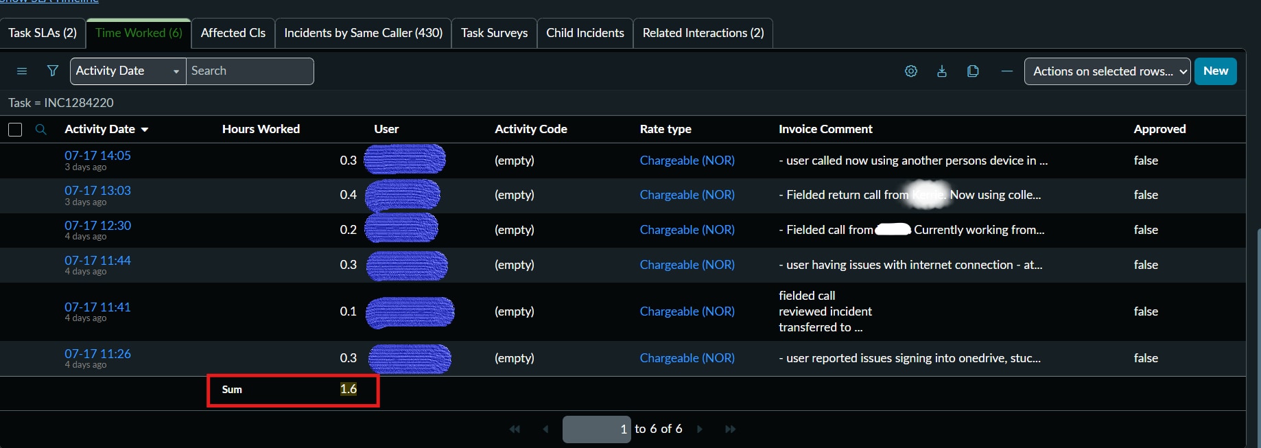

When servicedesk engineer works under a RITM or Incident the amount of hours work on each day is listed under the "Time Worked" related tab under the ticket as shown
I have seen for sum ticket the cumulative sum of "Hours worked"  column is displayed at the end of list labeling 'Sum' , But some tickets does not show as such.

List calculations are stored per list layout, and each form gets its own — the Time Worked related list on an Incident and on a RITM are separate layouts with independent settings.
did you tick Total value while on a RITM form, or on an Incident? Your screenshot shows the dialog open on INC1282813, and the box is unticked there.
To check what's already configured, open sys_ui_list, filter Table = task_time_worked, and look at the Parent column. A row with parent = sc_req_item means the RITM's list has its own layout; if there's no such row, it's never been configured.
To set it: open a RITM --->Time Worked related list --> right-click the Hours Worked header --> Configure --> List Calculations --> tick Total value --> OK
Note: my PDI doesn't have your custom hours worked field, so my screenshots use the OOB Time worked duration column.I think the calculation behavior is identical only display format differs.
Please refer screenshots, Also please do cache.do after changing the settings and then Reload the RITM.
