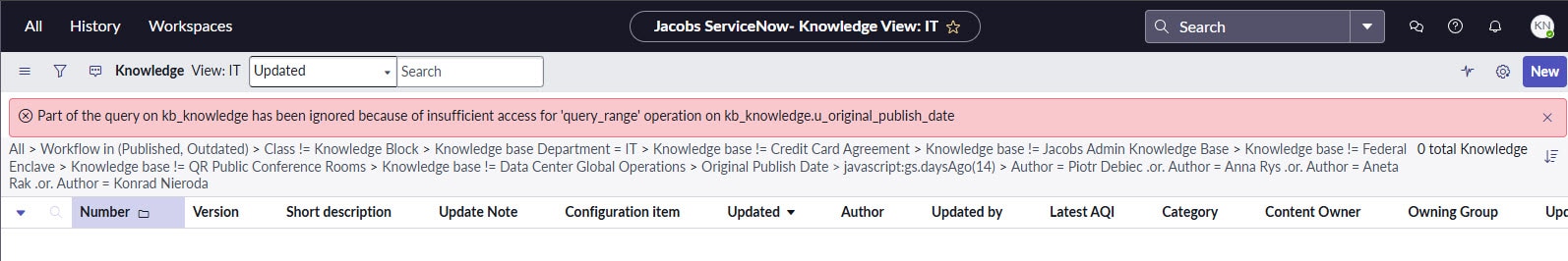

I need solution in finding the root cause behind this issue mentioned below.
Part of the query on kb_knowledge has been ignored because of insufficient access for 'query_range' operation on kb_knowledge.u_original_publish_date.
Our filter for AQI that relies on the Original Publish Date no longer works due to the error posted in the short description
https://help.jacobs.com/now/nav/ui/classic/params/target/kb_knowledge_list.do%3Fsysparm_query%3Dwork...
Attached is the screenshot.
Thank you.

Hi, you need to create a query_range ACL so that your field can be accessed.
You can create a new ACL with the following fields:
  • Type: record
  • Operation: query_range
  • Name: kb_knowledge from the table dropdown and u_original_publish_date from the field dropdown
  • Under Required Roles, add the roles that should have access

The issue stems from recent field-level Query Security changes in ServiceNow. The platform now applies query_match and query_range ACL enforcement on certain date and reference fields.
Since the user executing the filter does not have query_range read access to kb_knowledge.u_original_publish_date, the filter is being ignored.
You need to create a custom query_range Access Control List (ACL) rule for the affected field.
  • Navigate to System Security > Access Control in your ServiceNow instance.
  • Click New to create a new ACL.
  • Set the configuration as follows:
    • Type: record
    • Name: kb_knowledge and select u_original_publish_date from the field dropdown.
    • Roles: Add the roles required by users who need to execute this filter.
  • Save the ACL
