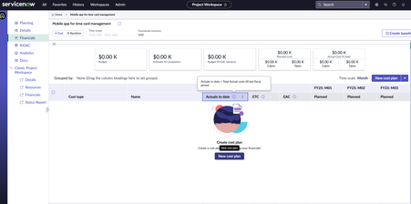

I have installed New project workspace and i see , Actual cost to Date is widget not showing the actual cost .
Project sample has expense line with state as processed .
Actual cost shows on the Native UI of the project.
Actual cost shows on classic project workspace
Actual cost is not showing on the New project workspace.
Please see the attached screenshots

Hi @Community Alums , the new financials screen only shows actual costs for past fiscal periods. Actual costs from current fiscal period are not considered in the 'Actuals to date' column and widget as displayed in the info icon message below .
This is to align with the new column layout of the financials screen which shows 'Actual cost' for past fiscal periods and planned cost for current and future fiscal periods. These values together should the Estimate at completion value for the cost plan (Actual cost for past fiscal periods + Planned cost for current and future fiscal periods), which can be compared with the allocated budget using the new 'budget vs cost' view to check if the project is over or within the budget.
If the user wants to see actual costs recorded agains current fiscal period for the cost plans, they can use the 'view expense lines' option on the cell context menu and see the actual costs recorded so far for current month. Once the fiscal period is past, the screen automatically shows the actual costs as shown below for FY24: M08

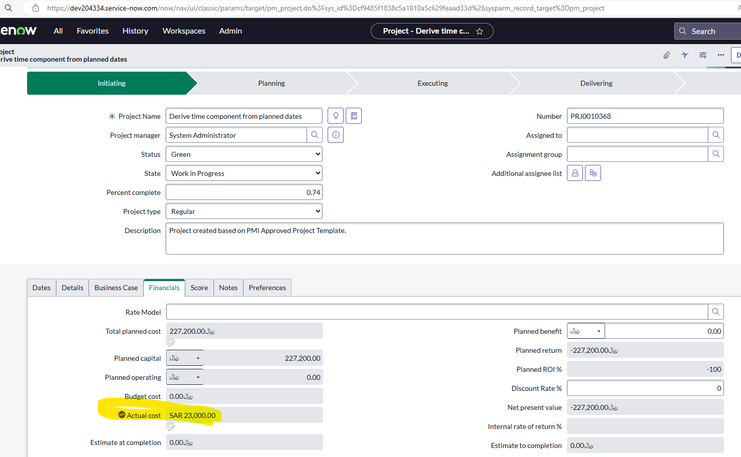

I updated the parent project only , not the sub project or project task.
if you see my screenshots its Actual cost getting updated in Native UI of Project & as well as in classic project workspace  but not in New project workspace
