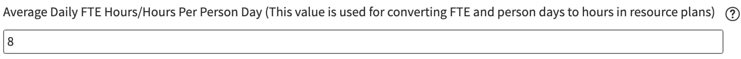

Average Daily FTE Hours/Hours Per Person Day and Hourly rate priority
01-12-2021 02:23 PM
If I set up Average Daily FTE Hours/Hours Per Person Day at group and at an user level, the user being part of the group, which value will have priority?
The same question is for the Hourly rate -- if I set it up at role and user level, the user having that specific role assigned, which value will have priority?

Hi
First of all it is not mandatory to set the Average Daily FTE Hours/Hours Per Person Day at group / user level. System automatically sets its value as 8 (out of the box) based on the value defined at the system properties (Properties - Resource).
However, if resource manager sets this value then it is used to decide 1 FTE / person days is equivalent to how many hours. This value will be utilized to calculate the planned hours on a resource plan when the resource plan is created in FTE / Person days.
Let's take an example:
Average Daily FTE Hours/Hours Per Person Day for QE-US-SFO group is set as 10.
Create a resource plan for 1 week for 1 FTE, the planned hours will be translated to 50 (10*5) which otherwise would have been 40 because out of the box value is set as 8 hours (8*5)
Similarly if Average Daily FTE Hours/Hours Per Person Day for user is set as 10.
Create a user resource plan for 1 week for 1 FTE, the planned hours will be translated to 50 (10*5).
There is nothing like group / user value taking precedence. These are used to calculate hours in respective resource plans as mentioned above.
Note: Capacity is not derived from FTE, but from the associated schedule. Both FTE and schedule must be in synchronization with each other.
