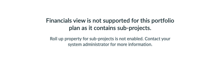

IMPORTANT POINT: In case planning items consists of the sub project(s), the Administrator need to set the system property - com.snc.project.rollup.cost - as 'true' in order to get the planning items on the Financials tab. In case this property is set as false and the planning items consist of sub projects then Financials tab would show below message.
Hope this helps!!
