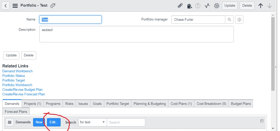

‎07-09-2021 02:23 PM
I tried this: On the Demand form, in the "Projects" related list, I used "edit" to select existing project. This did show the existing Project, BUT it did not set the sys_id reference from the demand to the project. SO if you look at the Demand list view the Project attribute does NOT have a value. Conversely, when you go to the Project form and look at the Demands related list, you do NOT see the new demand that was added to the project.
