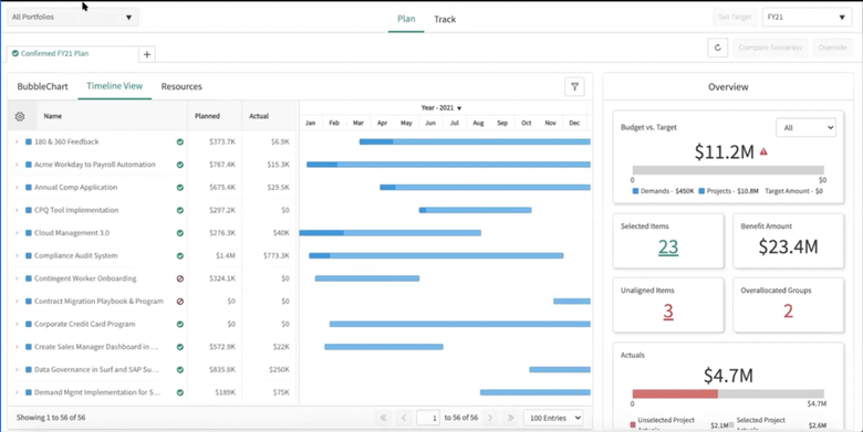

I'm trying to select an specific Portfolio in the Portfolio Planning Workbench but for some reason the button to select it is greyed out. I have to use 'All portfolios' since I can't change it.
I have several portfolios and even when I click in the 'Portfolio Planning' link from one of them, I still have the same problem.

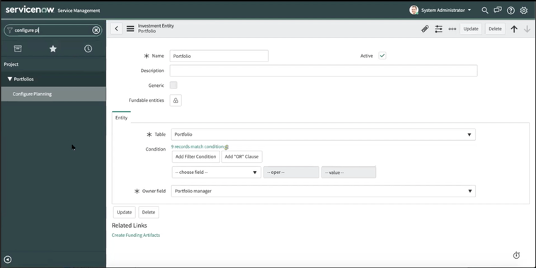

Select the Configure Planning from the Portfolios option present under the navigation panel.

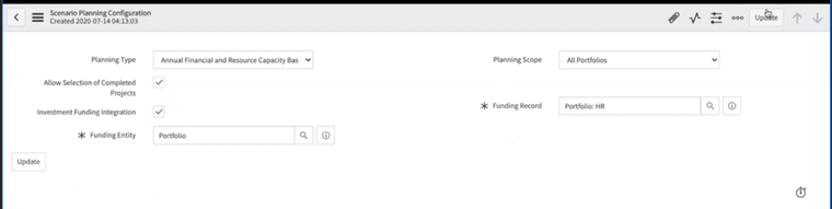

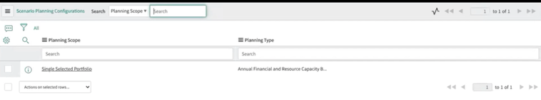

By default, the planning scope is set to Single-Selected Portfolios. With this setting as a portfolio manager you are able to select the portfolios as you were expecting.
But if the Planning scope is changed to ‘All Portfolios’ then you will get the information across all the portfolios and this means that as a portfolio manager you are not doing portfolio by portfolio planning but you are planning at the organization level across all the portfolios.
As a result of above setting, portfolio manager will now get ‘All Portfolios’. This is what you are also getting in your instance.
