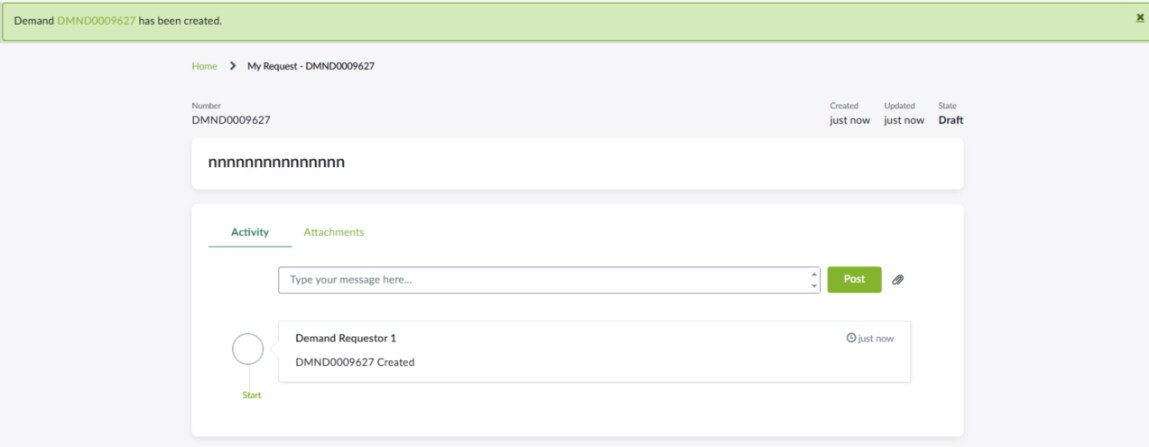

We are configuring the SPM demand management module. On submitting the service portal demand form, an OOTB pop-up message will display the demand number and hyperlinks to the respective demand on backend. However, we would not want to redirect the user to backend but instead, redirect to another page on portal.
Is there a way we could change the hyperlink, or at least remove the hyperlink in the pop-up message?

the message comes from record producer script
URL: https://instanceName.service-now.com/nav_to.do?uri=sc_cat_item_producer.do?sys_id=71ad2980eb221100b749215df106fe03
To remove the link to that record update as this in the 1st line
gs.addInfoMessage(gs.getMessage('Demand ' + current.number + ' has been created.'));

Hi Ankur, thank you for your response. We've checked the record producer doesn't have any script related to the pop-up message, seems like it come as default behavior.
