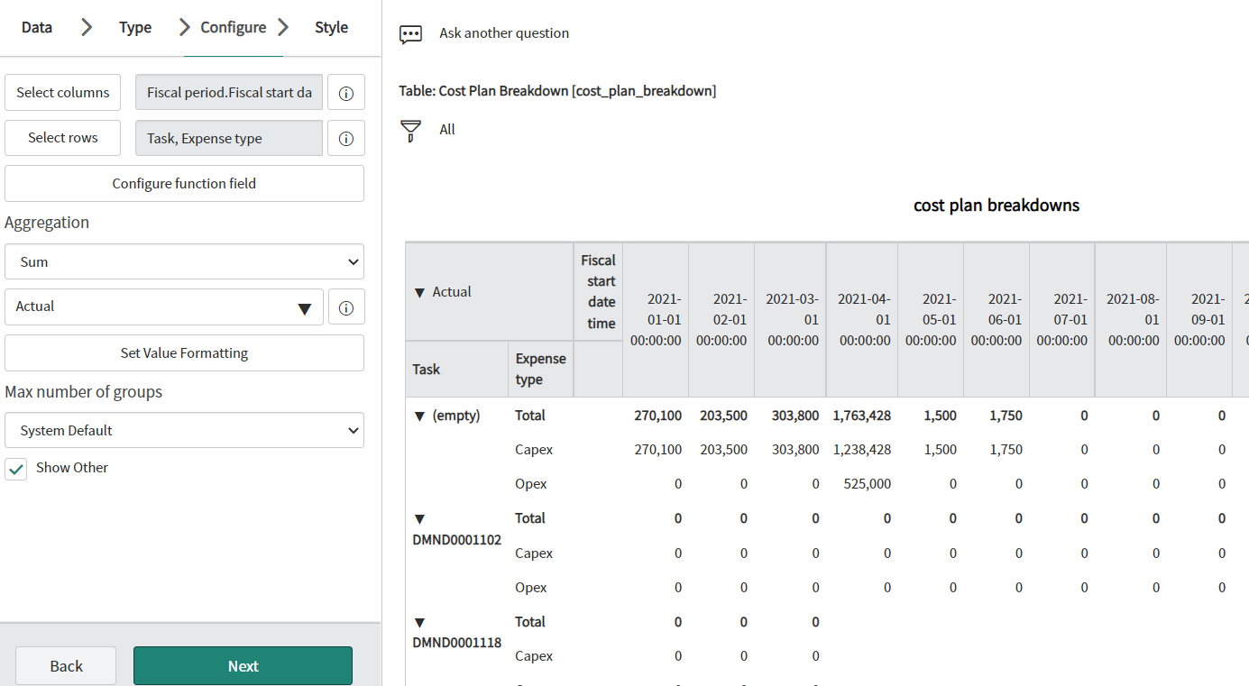

You do not have to combine the cost type table. There is already an Expense type field available on the Expense line table which you can use to group by on your reports.
I would suggest you create a Pivot type of report on your database view to display your data.
something like the below screenshot

For the report
create a pivot report on the database table you created.
in the filter add filter to week starts on this week
in the columns you can select the Week starts on from the time card table
in the rows you can select the task field from time_card table and User from time card table, and Expense type from the fm_expense_line table.
in the aggregation you can select sum for Actual/amount field of the expense line table.
