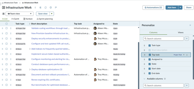

Irene5
Hi Joe,
You can edit the default view for the project task to add project name, and that will enable users to see the project name in the side panel when a user clicks on the task.
Then, to view the project name in the List view, personalize the columns and select 'Top Task'
Does this solve for your use case?
Irene
We plan to enhance this process in the future to make it more intuitive
