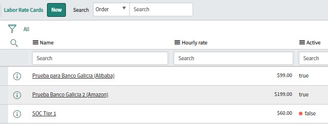

Hi Bammar, it helps me a lot what you told me and I prepared one case that I want to show you. I have success identificating users id and companies but I didnt have success trying to identificate the resource role (maybe it is not possible to identify Roles so you need to identify user by user).
So to resume, Without using Rate Model
if I want to request a Rol it tooks the rate defined to a Role
and when I confirmed or confirmed and Allocate a User of that Role it took the rate defined in the Labor Rate Card.
Thanks in advance to you and Namita!
Adrian Garcia
