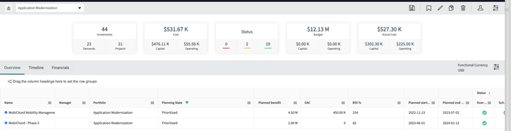

For Investment Portal:
FYI -
1) Planning State column is from sn_align_core_planning_item table.
2) sn_align_core_demand and sn_align_core_project tables are inherited from sn_align_core_planning_item table hence they do have this (planning state) field.

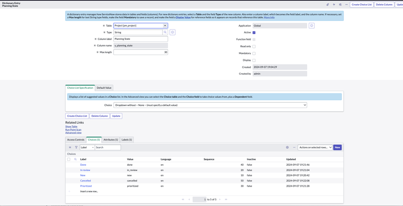

To add the Planning State column on the Investment Portal, first you need to configure this column for dmn_demand and pm_project tables.
Steps below:
1)Create Planning State field for Demand (dmn_demand) and Project (pm_project) tables.
You can create a String field - Planning State - in dmn_demand and pm_project tables similar to the one present in the sn_align_core_demand and sn_align_core_project tables.

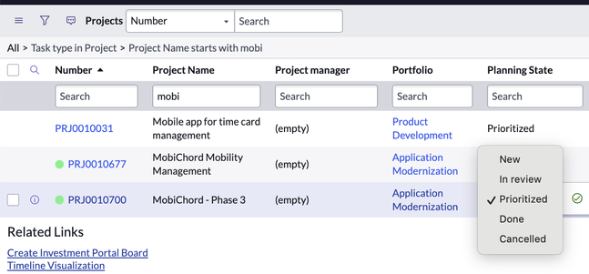

3) Configure the Planning state field for demand and project to update the field value
Screenshots below:
4) Configure 'Planning State' column on the investment portal
Screenshot below:
