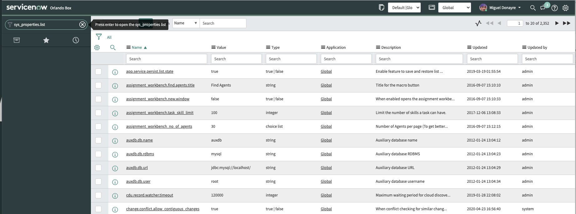

The default rate if there is not a labor rate card is set by a system property. (sys_properties.list)
OOTB it is set to 50 but you can set it to whatever you like.
To get there you need to type sys_properties.lisr in the navigation search bar. In the list view search for - com.snc.time_card.default_rate. In the value section, set the rate.

Miguel Donayre
