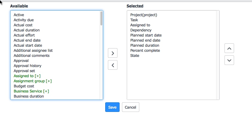

ITSMgal
Hi Dan
I'm wondering if this might help you.
There is a field in a project task called "top task" which is the project number for the main project. You can always expose this in a list view to show the project.
Also, there is a composite field called Project(project) that has the Top Task (project number) and the short description of the project.
Also, you can expose any information about that top task in the project list view. This way you won't have to do a "workaround" to see this information. Please reach out if you want to review this further. I am happy to look at what you are trying to achieve and recommend the best option.

Thanks Emily,
I have used Top Task in previous views and may resort to using it instead.   (Although I tried finding the Top Task in a report I was generating and it wasn't available ... that's a different topic.)
I am currently in an investigative state, trying to figure out what things are possible, what ways are the best for PPM in our IT department.   We have different Project Management Software for our core business and WBS is a key property that is used to identify categories and subcategories.   Being able to use names instead of numbers makes it much more readable.   I was partially hoping to define the whole project hierarchy in one field (i.e. the WBS) but even with the template allowing me to name the highest level using the Data field, it doesn't work for lower level project tasks.   The project name in the WBS was sort of a consolation prize seeing it in the WBS, coming from the Template, and I just threw out the question about renaming it since all associate project tasks now have my test naming convention within them and I don't want to go through the process of re-creating projects or manually changing all the tasks I created.
