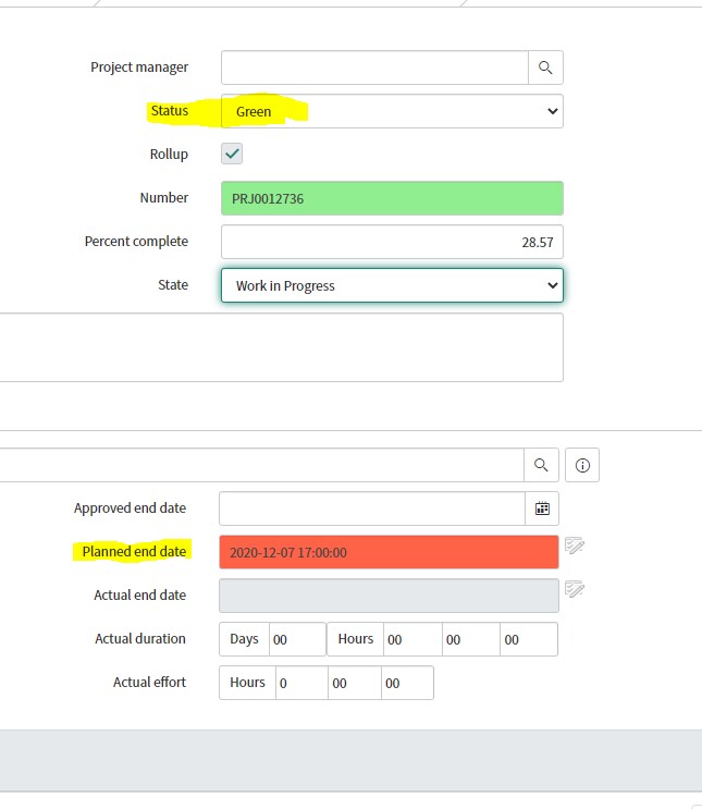

Hello Team,
I have a requirement like if any of the task associated to the project showing the missed dead line i.e. showing the red dot against the planned end date management need the Project should show in Red.
It shows the planned end date as Red but the Status is showing as Green,
Is it possible to change the status from green to red if any task is not got started as per the planned start date and the task is showing as red.

Is this the report you are referring .

Planned End Date color change is handled OOB via sys_ui_style. below is the sys_ui_style record which handles this
<YOUR-INSTANCE>/nav_to.do?uri=%2Fsys_ui_style.do%3Fsys_id%3D14fb3d7dc0a80a6d0da2e02f27db9a76%26sysparm_record_target%3Dsys_ui_style
as per your requirement , you can create a new style for status field and apply same logic.
Please create a new idea, if you want to see this in OOB in coming releases.
