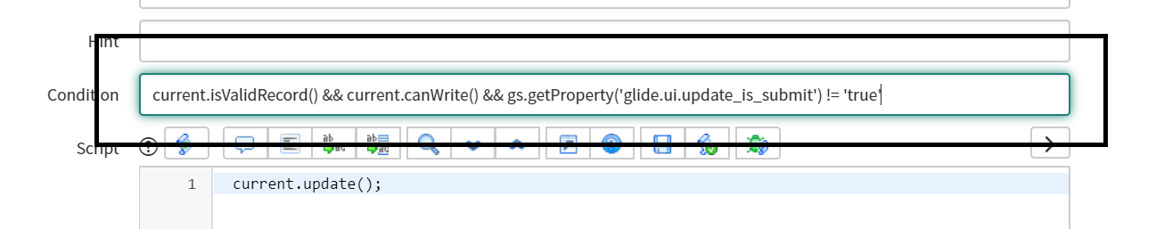

Hey Nirmala,
you can give condition in condition field like below screen shot.
 set the condition to false Or Can Try current.getTableName()!='custom_table'

Hi @Indrajit
Thank you for the response. It helped me in solution but it would be better if you could tell me how to hide update button only for my custom table on condition.
Example: If A=='true'{hide the update button of my table}
