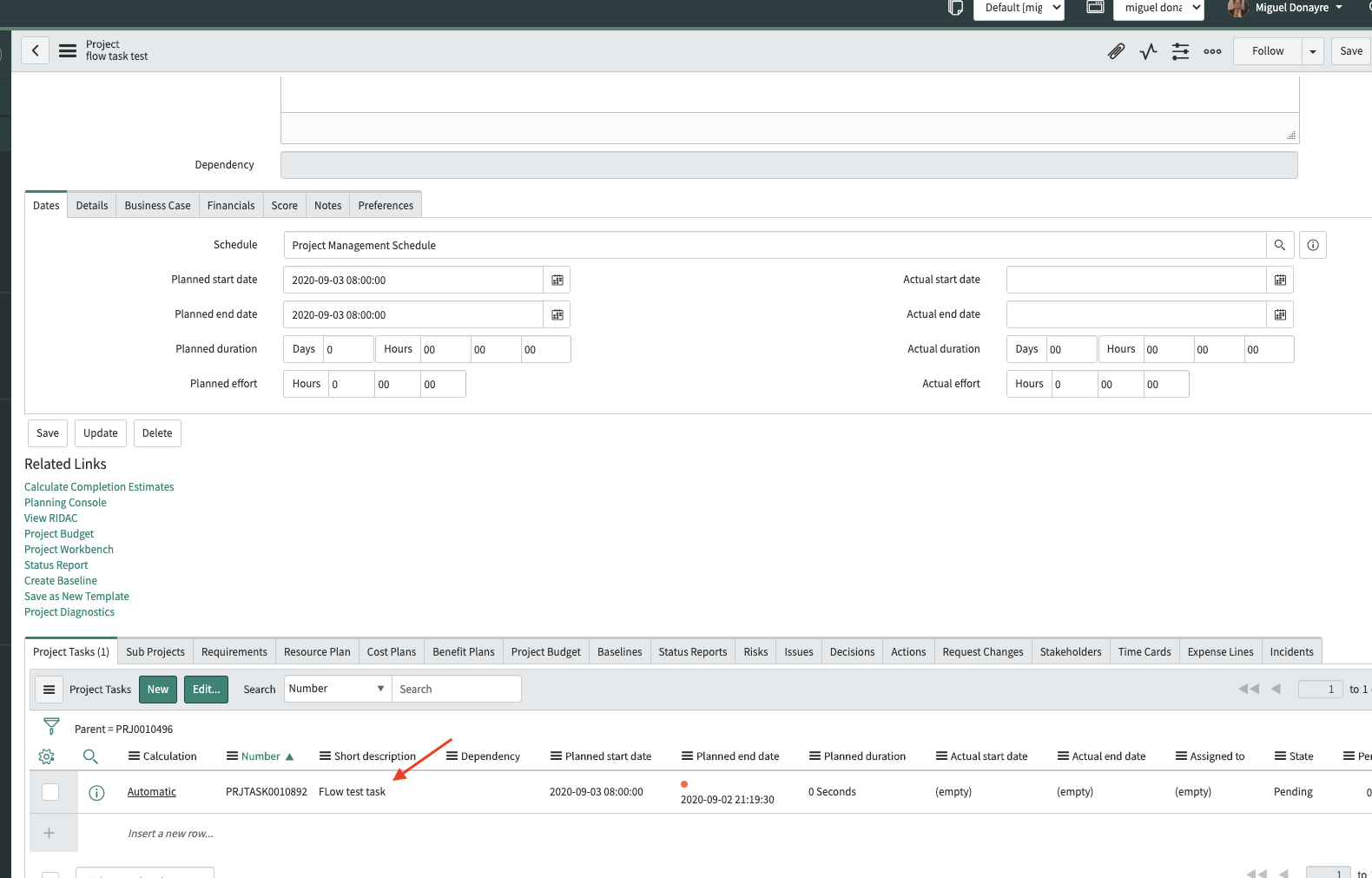

The new project task is automatically getting created. But How Do I associate with the newly created project task to the project number .
Can you please provide some hint here which field in the pm_project_task table contains the Project number and how do I link that
Here is the Screen shot which I have done
When I test it it is showing the task created but It it not displaying when I check under project .
You have to use the trigger record --> project record--> sys_id data pill to relate the project task to the project.
I just created a new Project and the tasked showed up with the flow
