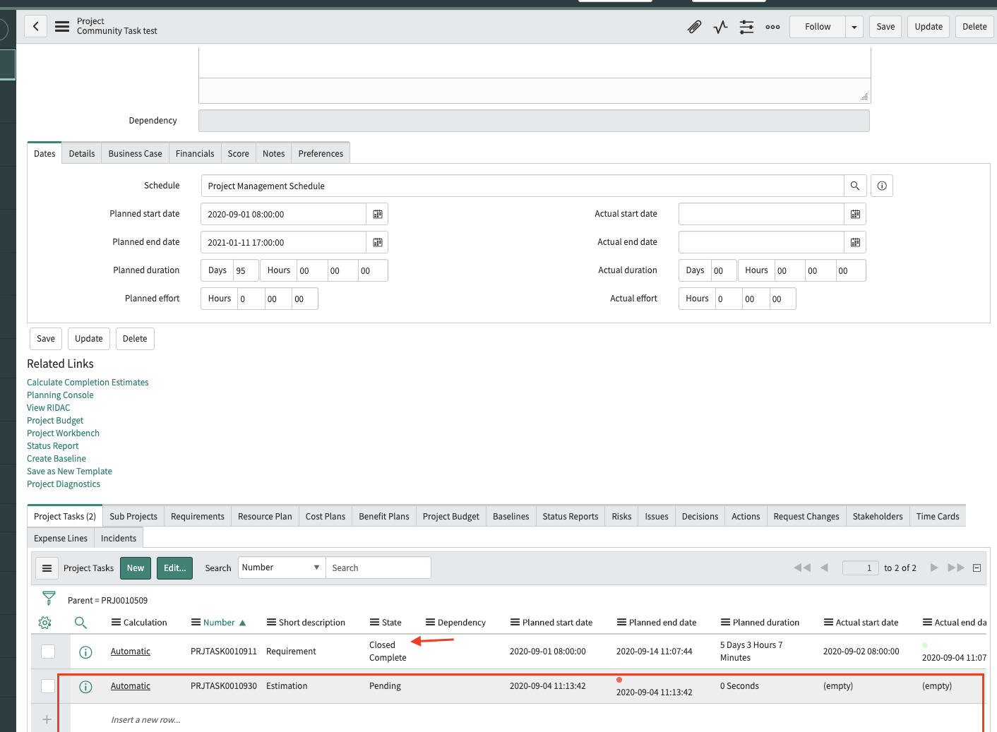

The example project I used doesn't switch to closed complete with the task is closed and complete.
Here is the step you can do to set the State for a project. Find the "Update Record" action and add it. Drag the Trigger - Record created --> "Project record" pill (the enter pill)  in the record filed.
Once it's added, it will pull all the fields you can edit into the action. Pick the State and change the State you want. It will update after the last task is complete if you have the wait check off. You also set the Phase this way as well, switch the state field to phase.
After closing out the last task in the flow, it changed the State.

Hello
I got it working in my instance -
CLosed out the 1st task - the flow created the next task
