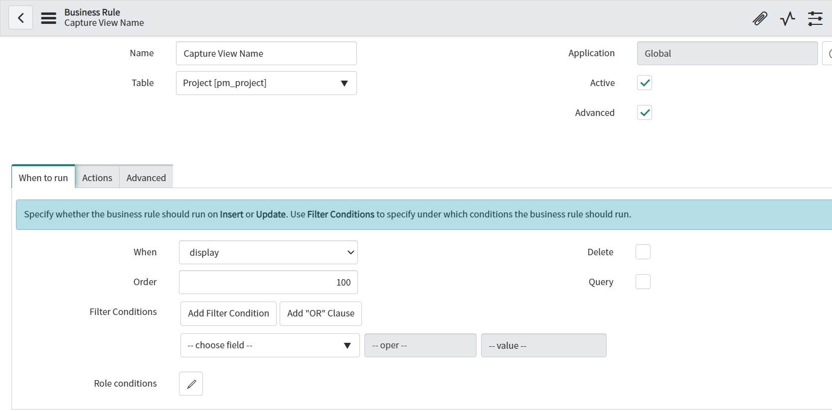

There can be other ways to handle this, what I can think of and works for me is listed below:
1) please create a new hidden field on your Project Table say name it as "View". This is required to capture the view which is getting loaded on Parent Project form and is needed to validate the child Related List.
2) Now once this field is created, create a UI Policy and hide this field so that it is not visible to users.
3) Now Please write a Display Business Rule and use the script below to capture the View name:

Now write an On Load Client Script on Project table i.e. View Name and use the script below to set your View Name:
function onLoad() {
g_form.setValue('u_view_name', g_scratchpad.VIEWNAME);
Now once this is done, Right click on the header of Project Task Related List and then select Configure--> List Control as shown below:
Now use the script below in the field "Omit New Condition" as shown below. If this field is not present then add it to the Form layout and then use the same script as shared below:
if(parent.u_view_name == 'planning_console'){ // Replace "planning_console" with your custom View Name
answer = true;
}else{
answer = false;
Output:
This works for me in my PDI.
