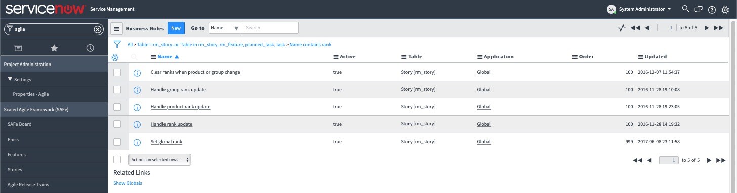

Or look in the Business Rules for rank on rm_story table
