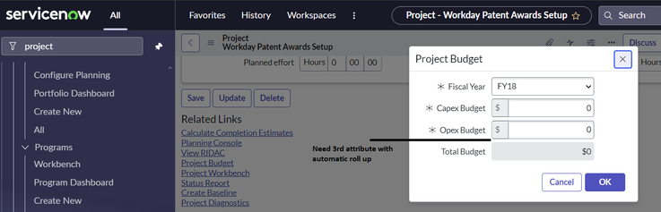

We have a requirement to create new expense type. Understand that it is not the best practice to create a new expense type field, however the requirement is to manage the 3rd expense type together with Capex and Opex. Since the Capex and Opex are referenced extensively from project budget, cost plan, portfolio planning, investment portal is there any solution in adding a new expense type.

Thanks for the reply. We explored the option of adding a new cost type. However, the requirement is to add a third expense type everywhere where we have a reference to Capex and Popex. If we add it as new cost type, we are unable to add this new expense type as project budget.

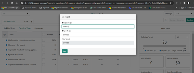

Similarly for every applications like the scenario planning, we need to add a third attribute and manage it separately from Capex and Opex.
