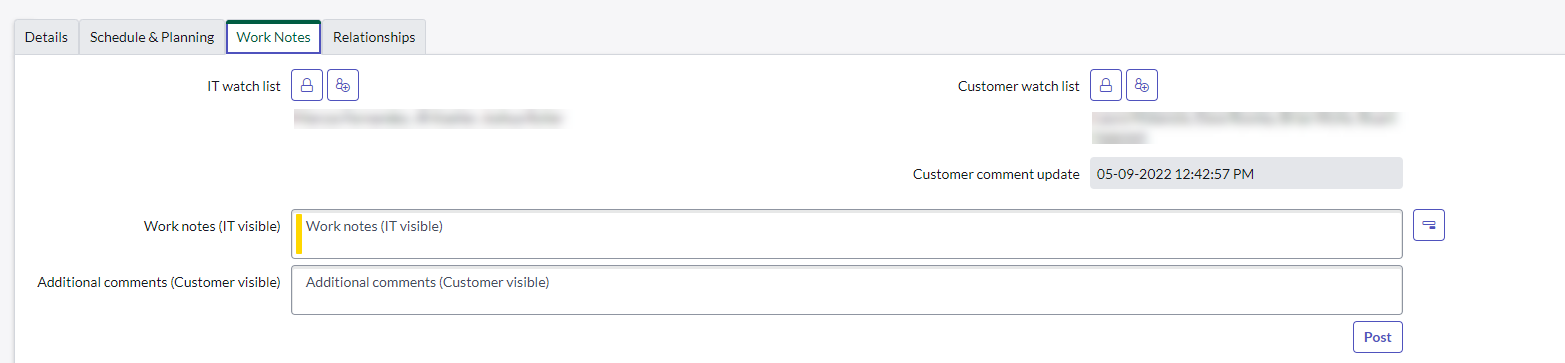

When we used Enhancements we had notifications going out to the requestor whenever the Enhancement changed state.  We also used the Work Notes a lot to communicate with the customer.

Our Enhancements have always had the ability to send customer visible work notes.  I am not sure if that was something we developed or not as I was not with the company when Enhancements went live.  Our customers also had a view only view of Enhancements on the Portal.  So when they got an e-mail with the work note there was a link for them to view the Enhancement on the Portal and add a note or they could reply via e-mail to add a work note.  The business users were very thankful to have access and able to communicate with us.
