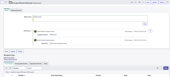

From sprint tracking -> story board, when scrum team member, moves a story (for unplanned work), to another lane (lane = vertical columns. Note: vertical columns by default represent the state of the story), the state of the story changes, however the state of the original triaged record remains the same.
In order to change the state of the original record, open the record in the form and use the 'Open original record' related link.
