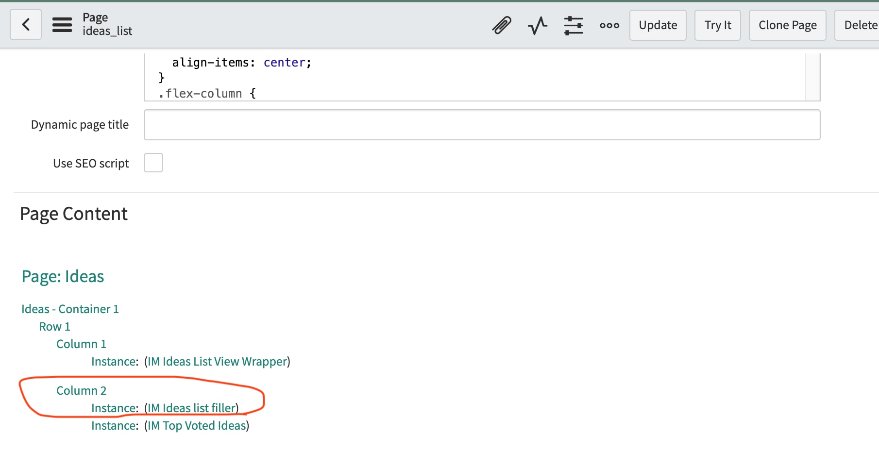

  1. When an idea portal is selected, a new page opens. and that’s because of the URL Argument (/idea/?id=ideas_list&sysparm_module_id=internal)
  2. Then it goes to the portal with the URL suffix “idea”. You can check this in the service portal as shown in the image below.
3. Then a home page with “idea_list” opens up. This page will basically list all the ideas with the module name - “internal”
4. While the “idea_list” page is loading, you will see the widget “IM Ideas list filler” pulling data from the table “idea” and filtering out based on the module idfind_real_file.png
Let me know if this is of help. Thanks.
