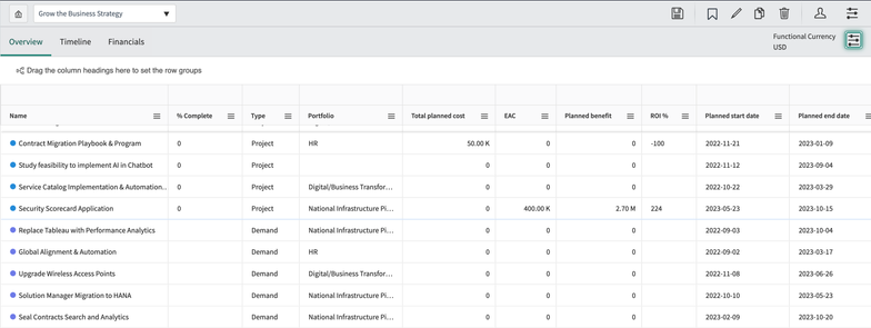

  2. In the roadmap view, I can turn on tracking mode that shows % complete.  % complete pulls through for the projects, so I understand how it's set for those, but where do I control % complete on demands? I don't see it as a field from any view. Am I glazing over it somewhere?

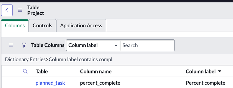

%complete field is present in planned task; it is NOT present in the task table.
Hence it is in the project table (as mentioned above because project is extended from planned task).

Additional  Note: Percent Complete is not available in demand that is why on the Investment Portal when you configure the 'Percent Complete field, you will notice that Percent Complete will be blank for Demands.

Thank you for the thorough explanation Namita!  I think then, it's just an odd design choice to show 0% when in tracking mode for a portfolio plan for demands, if the demands have no way of moving past 0%.  I would think it just shows no percentage, otherwise this is confusing when briefing up to management
