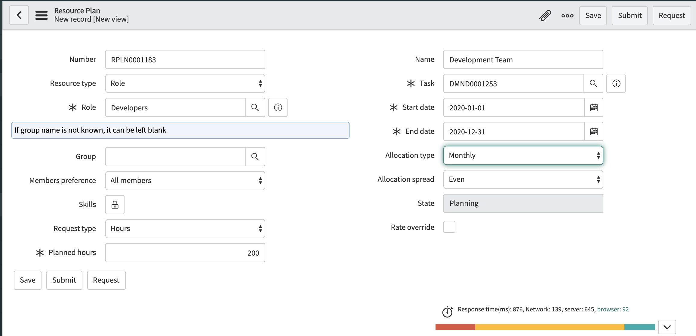

Once done, I created a Demand and under it, I created a  Role-based Resource Plan and I am expecting to see the Planned Cost to be calculated based on the Rate Model that is attached to the Demand. Unfortunately, it is multiplying the Planned hours with $50( not sure where it is coming from) , checked all the related setups.

Thank you so much Miguel, it helped me fix my Rate Model. but the Planned cost on the Resource Plan is still taking $50.
The Allocation Cost on the Resource Plan is correct.
Rate defined in the Rate Model * requested hours.
But Planned Cost is
Default Rate(50) * requested hours.
Steps I followed:
As advised I have corrected my Rate Model,
 2. Setup the Rate Lines accordingly
Step 3. Created Resource plan using the Rate Model created above, the Allocation hours is coming correctly based on the Rate Model, but Planned hours is incorrect.
