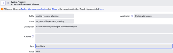

Based on the shared screenshots, it looks that the sn_pw.enable_resource_planning property is set as false in your system. This property is by default false and pps_admin need to change it to true if you would like to use resource assignment via project workspace.

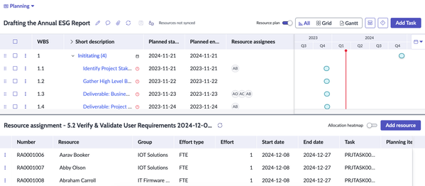

Once you make this property true, you will notice
1) Resource plan toggle in planning console (of new project workspace).
2) Toggling on the resource plan, you can see the resource assignment pane in the lower section of the planning console (of new project workspace).

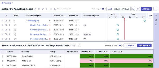

 You can also toggle the allocation heatmap to get the view as shown in below screenshot:
3) The resource assignment will start appearing in the related list (as it is already selected in your case in the related list layout configuration (third image)).
