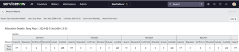

To check, you can also execute the 'Allocation Details' for this user and the complete information will be provided in below format:
