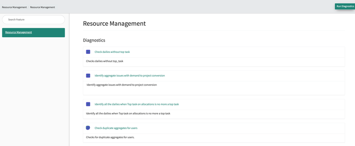

11-30-2023 05:50 AM
Hi @gnaresh1222 ,
I am expecting that you can access the instance as pps_admin.
Typically this kind of issue happens when the resource aggregates gets corrupted due to some reason.
With the limited information in hand, I would suggest you to check if below steps resolve the issue:
1. Login as pps_admin
2. From left navigation panel select, Resources -> Resource Diagnostics
3. Select the different options present on the UI and click on 'Run Diagnostics'
4. If there are any issues, system will list them and from there it will be easy to understand the root cause and take the corrective action.
Let me know if the above suggestion works for you.
Thank You!
