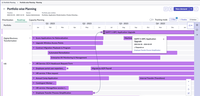

Q3) How to  to view the program relationships / dependencies?
Answer) You can get the program dependencies from 'Strategic planning workspace' (SPW).Basically if the planning item of one program is dependent on another program, these programs are dependent on each other.
I have the data setup for portfolio dependency, below is the screenshot. Similarly you can get the program dependency.
Hopefully above points are answered. If yes, please mark the response as correct answer.
