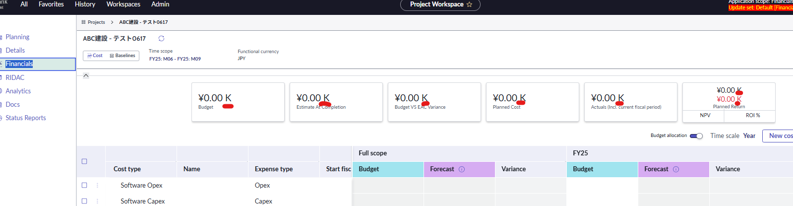

Hello everyone,
I have a question about the Financials section in Project Workspace.
At the top, amounts are displayed using abbreviations like "K" and "M."
Is there a way to show the full numeric values instead?
In Japan, it's standard to display full amounts without abbreviations—for example, showing 100,000 instead of 100K, or 1,000,000 instead of 1M.
I would like to display the amounts without using "K" or "M."
Thank you,
