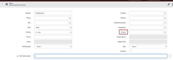

Here is the Story Form:

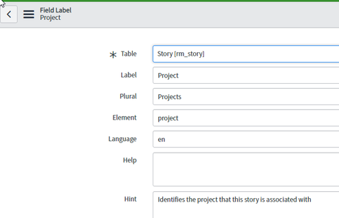

Here is the Field Label:

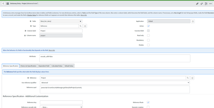

Here is the current Dictionary Entry:
Here is the table info for the 'Project' field:

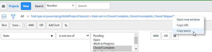

Just go to Projects table in list view and apply the required filter with state field.
State -- Is not one  of -- 'Closed Complete', 'Closed Incomplete' and 'Closed Skipped' states.
Run the filter and copy the query by right clicking on it.
Now go to any Story record and configure the Project field and in Advanced reference qualifier or override advanced reference qualifier add the copied query as-

I went to the Projects in List View and set the filter to exclude projects with "Closed Complete', 'Closed Incomplete' and 'Closed Skipped' and copied this query:
I updated the Advanced Reference qual on the 'Project' field from this:
javascript:ScrumSecurityManager.getStoryDotProject(current);
to this:
javascript:ScrumSecurityManager.getStoryDotProject(current);sys_class_nameINjavascript:getValidProjectClasses()^stateNOT IN3,4,7

Looking at the screenshot it seems you already have a custom script in the reference qualifier:-
So you will have to first check what exactly is the script include really returning and you probably have to add the extra query in the script include itself.
