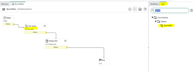

Please find below Screenshot for reference:
1. Use Run script activity in Workflow

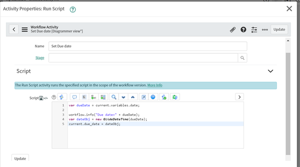

2. Write below Script inside Run script activity
var dueDate = current.variables.date;  // you can change variable name as per your item
var dateObj = new GlideDateTime(dueDate);
current.due_date = dateObj;

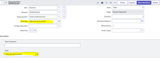

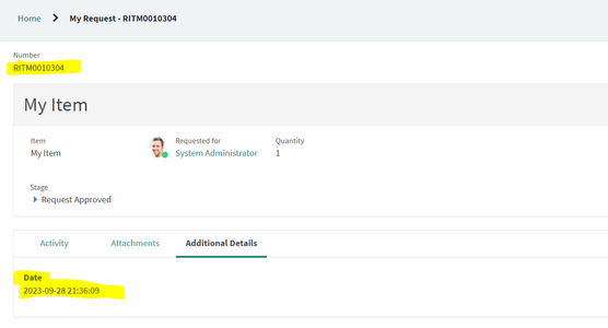

Output :
