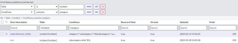

Hi @hosmmz ,
You should go to your UI Policies and verify the order you have listed on the specific table / field just as shown below:
Based on your finding, you should decide which UI Policy that should come in which order, and then change the order.
