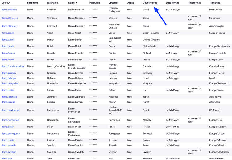

Just one thing to add, that property should not be changed post go-live as detailed here,
If you need to update the "Country Code" of a user, it's a field already present on the [sys_user] table,
Which when used would look like this:
