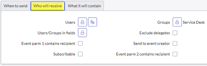

I enabled a notification record to be triggered when comments are entered on a RITM.
All notifications are sent to the Service Desk assignment group; however, I want to help reduce the number of notifications that are sent by creating a script to do the following:

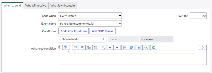

| When to send This is where I need the most assistance, particularly with the script based on what I want to achieve.
| Who will receive

Hi @xwharton Write below script into Advanced Condition field
if ((current.comments.changes()) && (current.sys_updated_by == current.opened_by || current.sys_updated_by == current.requested_by || current.sys_updated_by == watch_list)) {
answer = true;
Refer below Screenshot

02-06-2024 06:52 AM
@Sid_Takali
I tried the script that you suggested, and the result was that no emails were sent to the Service Desk assignment group.
When I remove the code emails are sent, however, there is no filter for comments left by fulfillers.
I even tried modifying the script to include the following and encountered the same result:
if (current.comments.changes() &&
watch_list.includes(current.sys_updated_by))) {
answer = true;
} else {
answer = false;I also tried the following combinations of the conditions plus the advanced conditions:
| Combinations |
| Event Name: sc_req_item.commented.itil + Code referenced above as well as the code snippet that you provided to me |
Event name: sc_req_item.commented + Code referenced above as well as the code snippet that you provided to me |
