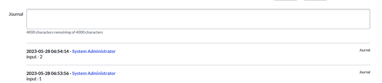

HI @RanjaniM ,
Journal fields display all the entries on the form itself, the entries are displayed below the journal field itself.

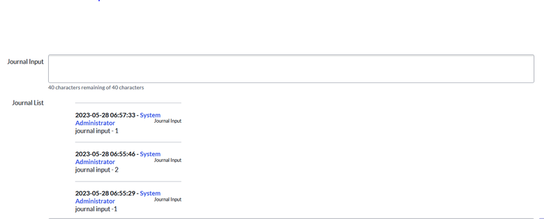

On the contrary, Journal Input fields does not display any entries on the form, if you type something in a field which is of journal_input type, after saving the form you will not find that entry anywhere, for this reason, Journal Input type fields are used in conjunction with Journal Lists.
Journal List displays all the entries which were made on the journal input or journal field
Journal list fields are made dependent on the journal_input type fields, example : the work_notes field on the incident form is of the type journal input
