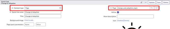

We have configured a Quick Link to redirect to a Page as below:
However when we add the link on the Employee Service Centre, using the Quick Link widget and a user clicks on the link it takes them to the page without the header, banner or any of the descriptions:

When I navigate to any of the topics, this is the page which gets loaded. I am assuming you cloned this page to create change_and_adoption_topic. This should work fine.
However, whenever I navigate to a topic, servicenow passes a parameter called the topic_id="sys_id of the topic".
In the quick link above I do not see you are passing any query parameters.
I created a quick link on my PDI, and tried re directing from it to a topic page, OOTB one. Added the topic_id parameter and it worked okay. if I try to navigate directly to the emp_taxonomy_topic page, it gives me error.
Please accept solution OR mark helpful.
Hello @ahefaz1 - when I access the page via the topics, it works just fine. It's only when using the Quick Links to the page that it seems to have a problem. Interestingly, the URL it directs too is different.
Via the topic, it goes to (which has the Topic ID): https://instance.service-now.com/esc?id=change_and_adoption_topic&topic_id=894a4f0c47327d9054ce4bdb736d4319
via the quick link it does not add the topic ID: https://instance.service-now.com/esc?id=change_and_adoption_topic
If I add the topic ID it shows the header.
