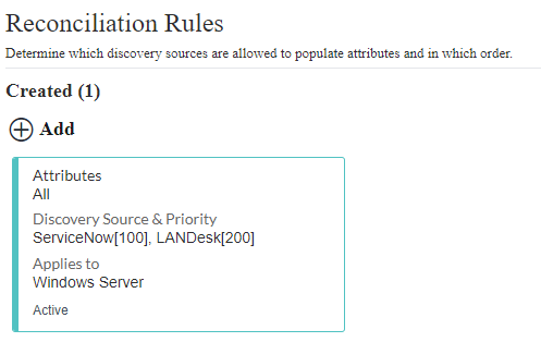

‎03-14-2022 12:51 PM
I had someone from work help me out and it turned out to be as simple as I thought it was. He told me to take out the filters and it worked.
He explained that the order alone should take care of it without the need for filters. It was the one thing I thought of but didn't actually try because I was overthinking it and thought it would require filters.
I left it as ServiceNow > Priority 100 and LANDesk > Priority 200 with no filters.

- Windows Server record in CMDB with discovery source LANDesk CAN be updated by discovery source ServiceNow
- Windows Server record in CMDB with discovery source ServiceNow CANNOT be updated by discovery source LANDesk
What???
We just need to add a reconciliation rule that:
- has 2 discovery sources (servicenow =100; LandDesk = 200), and
- apply to all attributes
That's it.
