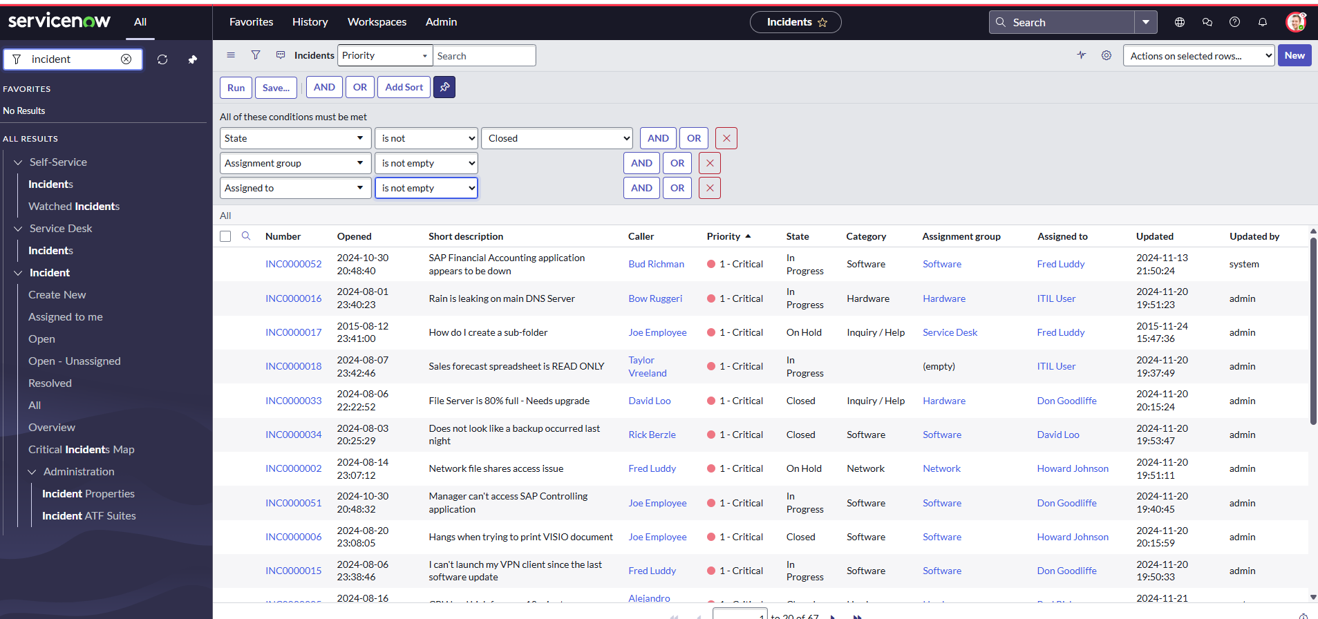

I am having issues with the lists and filters tasks. It is stating to change the state to in progress and that I should change the status to 10 records. My problem is I see most of them already have in progress as the status, but the one that currently has on hold status once I highlight it, I am not getting the option to change it to in progress and also I cannot change the status of the category of one to software as requested. Here are the instructions.

First, from the screenshot you didn't click the Run button to execute the filter (step 4). Once you have all of the States highlighted, double-click one of them that has a different value to make the field editable, then whatever you change it to will be the value on all of the highlighted rows, even if that already was the value.
