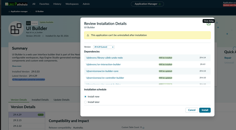

When I clicked on update UI Builder I was redirected to login page which says "Sorry, you can't login with this ServiceNow ID".

Go to Plugins and try to update it from there. If there are no dependencies, the plugin should update successfully; otherwise, the update may not proceed.

Is it your PDI?
If it is your client instance - You need to login using customer/organization ID.

Hello @Tanushree Maiti
Thank you for your response. My issue is resolved.
I'm using PDI and updated the UI Builder by navigating to System Definition then Plugins.
