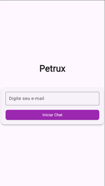

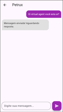

I managed to finish the integration and have already integrated it into an app for testing using Flutter.
