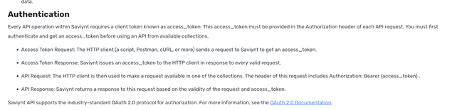

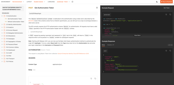

According to Saviynt's documentation you are correct that a bearer token needs to be sent in Authorization header but before that an initial request needs to be made to retrieve that token. In that initial request the Saviynt service account credentials need to be sent in the token request. Token would then be extracted from the initial request and placed into the request for data.
Sequence:
- Token request (a POST request with the credentials in the body of the request)
- Note: the response will also include a refresh token which can be used afterwards to get new tokens
- Retrieved token can be used to send a GET request ( token should be in the header as a bearer authorization)
From the Saviynt documentation :
https://docs.saviyntcloud.com/bundle/API-Reference-Guide/page/Content/Overview.htm

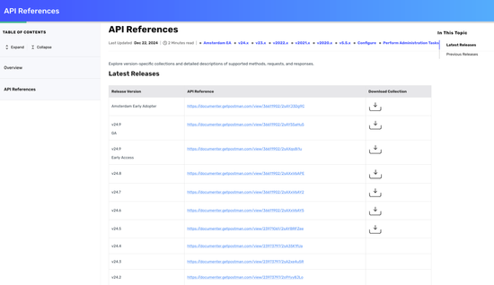

From the documentation they supply a practice playground and a Postman setup
https://docs.saviyntcloud.com/bundle/API-Reference-Guide/page/Content/API-References.htm
https://documenter.getpostman.com/view/36611902/2sAXxV6APE
