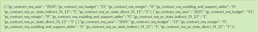

Is it formatted like this?
Or are the [] missing, or are there extra " or other formatting characters,...?  Are you using the native UI, or Service Portal / ESC / ...?  If you look in the browser tools, do you see any errors in the console log?
