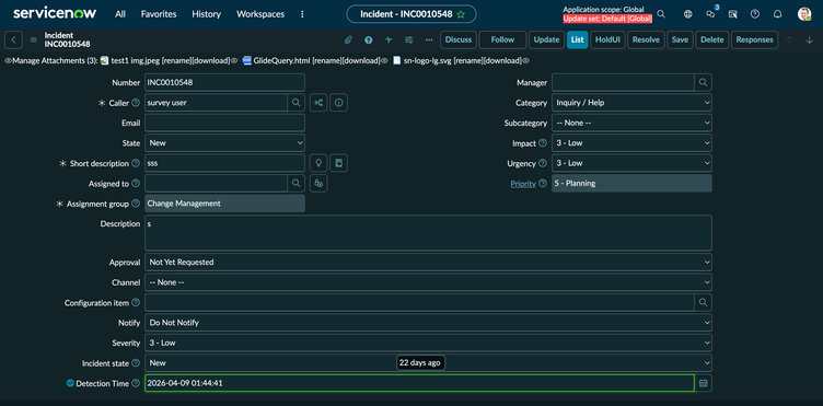

04-30-2026 02:13 AM
Hi @Rakesh_M ,
I have tried same script in After Business Rule but did not work for my side, please refer below screenshots and suggest if any wrong on script side.

04-30-2026 03:13 AM
Below is the condition have given in Business Rule and could you please confirm the Business Rule have selected incident is it correct right?
04-30-2026 03:28 AM
hi @ashok17 ,
Please update the table name to the Alert table.
The current Business Rule works when the Incident is created first, and then the Alert is created — in this case, the Incident gets updated.
If your use case is different (for example, creating the Alert first and then the Incident), the script will need to be adjusted.
Could you please confirm your use case?
