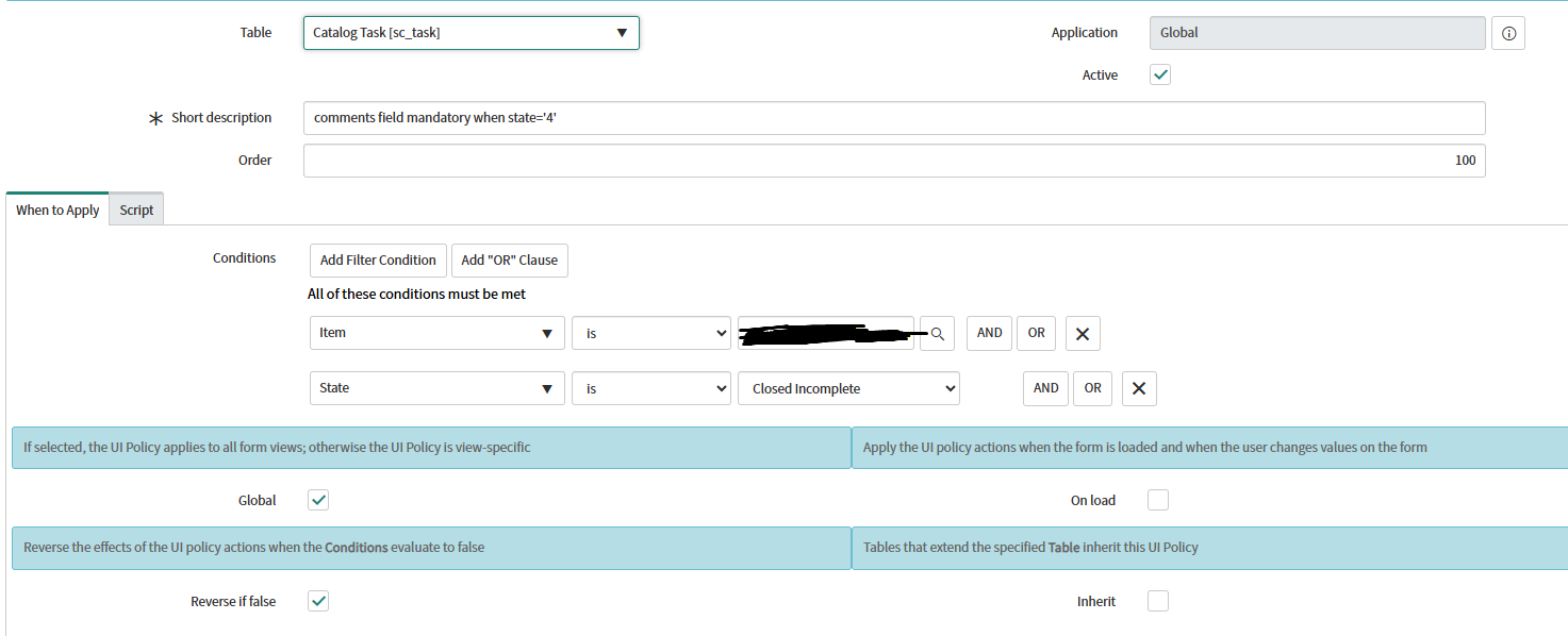

i need to mandatory Additional Comments (journal input type) when state = close incomplete (value = '4')
i try to use  ui policy with ui action, i try to use client script, but it's doesn't work, the field doesn't become mandatory.

I found the solution - inside ui action there are 2 reference folders that I needed and didn't know they were there:
1) Request
2) request item
And inside request item there is the "additional comments" field, that I was looking for, it mandatory the field.
in UI Policy Action you have "Field Name" field and inside you have folders, two of them are Request and Requested item.
this is what i searching for.
Thanks to everyone who tried to help 🫶🏼

It is working code/configuration.. implement this way-
1)Create UI policy on sc_task
2)Go to Script tab,
If execute True, Write ur code as per your requirement.
Sample:
