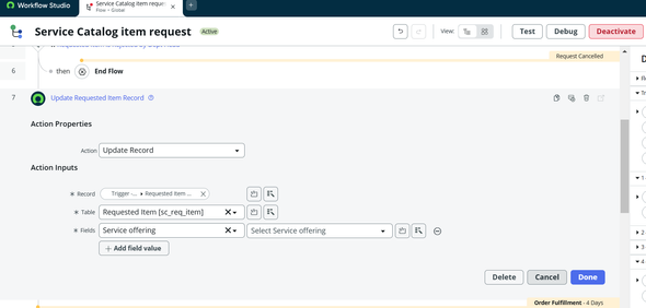

Hi @TimothyD9136024 ,
If you creating the process engine via Flow Designer then with the help of Action Update Record and then select the trigger point which is actually an RITM record and then you can update any field of an RITM record. Refer Snip
Or you can also create an Business rule on RITM table, with condition "Item" = "Your Catalog Item" and set the value of your required fields as per your use case.
